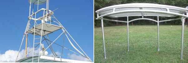

The choice is simple. Unless you are in the business of welding marine tuna towers..., get a foot pedal amperage control.

welding tuna towers

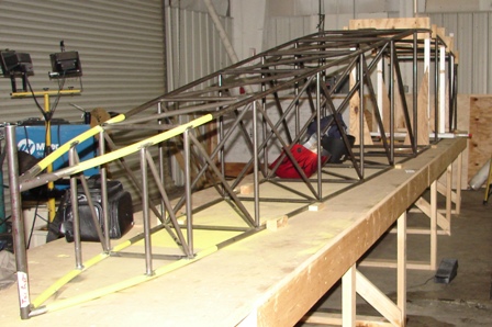

If you are going to be doing a lot of remote welding like on a tuna tower or chromoly airframe, you should probably get both...a foot pedal for bench work, and a torch remote for out of position work where dragging a foot pedal around is kind of a hassle.
Miller accessory kits usually have one or the other ..and the same with Lincoln.
I think the best idea is to start with a foot pedal and go from there.
welding chromoly airframe
