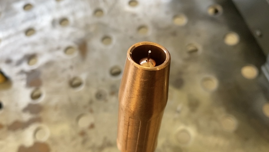

Stick out and trimming the nozzle on the primeweld mig 180
primeweld contact tip recessed
primeweld contact tip trimmed
Did you know that when you use a longer stick out, your amperage actually drops?
Thats why I prefer to use a short stick out with short circuit mig welding. I notice less spatter, a crisper arc, and the puddle is noticeably hotter.
Some contact tip and nozzle setups have the contact tip recessed a bit more than I like for short circuit mig welding.
A recessed tip works great for spray transfer mig, but I'm not going to be doing any spray with this welder.
I prefer the tip to be flush for short circuit mig so I trimmed about 1/8" off with a grinder.
