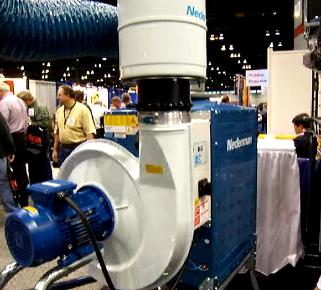

The last and most versatile fume extraction unit I saw at the Nederman booth was called the Filter Box Modular Extraction /Filter System. This unit is a box design that can be used as a portable roll around unit, or a wall mounted unit with single or dual extractor arms, or as a ceiling mounted fume extractor.
welding fume extractor system by nederman
Self cleaning long life filters with a bucket on the bottom for easy emptying of debris seemed like a simple yet very effective and useful design. Also, the externally mounted motor and blower were able to be right-sized for the application.
Like I said , this was the most versatile fume extractor I saw.

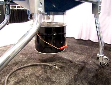

nederman fume extractor bucket
What really impressed me, was the plain metal bucket fastened to the bottom to empty the debris. They could have designed a sheet metal tray that might have looked more sleek, but the designers chose to keep it simple and effective…
In case you haven’t figured it out yet, I am all about simple and effective.
