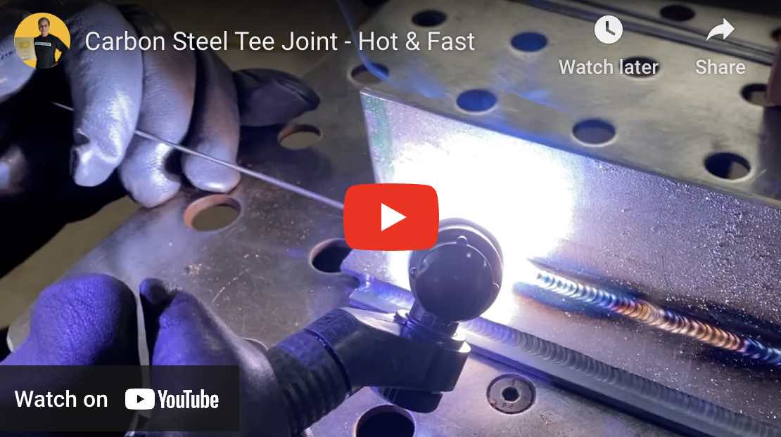

TIG welding a mild steel Tee joint 11ga cold rolled steel
mild-steel-tig-tee-thumb
The video above shows mild steel tig welding on a 11ga cold rolled tee joint.
Travel speed is a big factor and the faster you can travel the more amperage you can use.

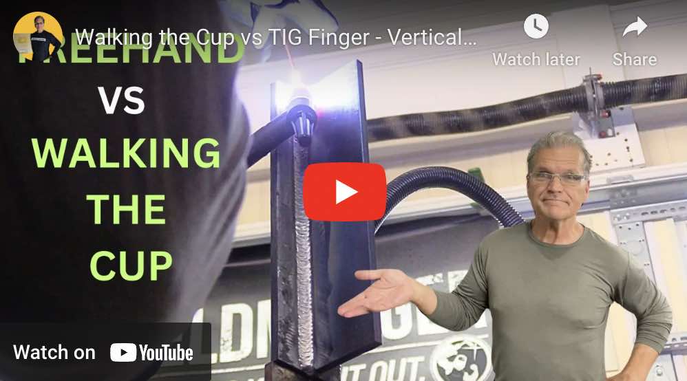

Walking the cup vs Freehand on a Mild Steel 3F tee joint
3f-tee-freehand-walking-the-cup-thumb

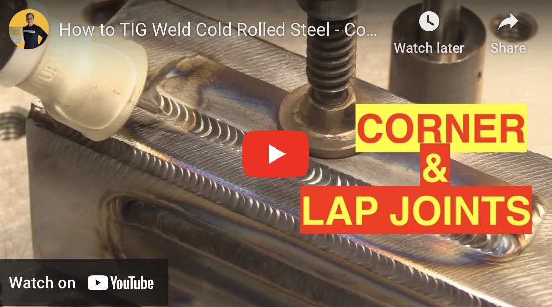

Corner joints and lap joints 11ga steel
corner-lap-joints-mild-steel-thumb

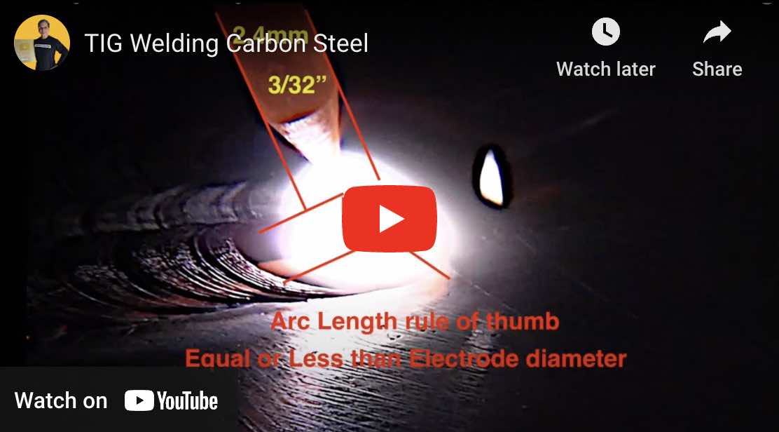

Arc length tips
mild-steel-tig-arc-length-thumb
