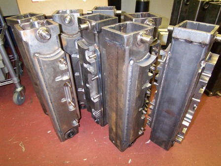

Several times a year I take on a project where I weld about 20 parts that are essentially a piece of 4” square tubing with ¼”wall thickness to 2 pieces of 1 inch thick steel machined plates.
Each part has over 80 inches of weld.
I get paid by the job on this project , not by the hour so I am always looking for good mig welding techniques that save time and still look good and are sound welds.
What I have found is that by not overlapping loop on this mig welding technique, it speeds up travel speed by about 30 to 50 percent. The welds I am doing on these projects need to look good , not have any pores that would leech out at the plating shop, and need to be sound welds but not very big because the heavy plates being welded are added just for weight.
So what I do is set the mig machine which is a plain old millermatic 250 to around 21 volts and about 280 inches per minute of wire speed using er70s6 .035” wire and I hold s short stickout and weld a series of U’s or I guess you could actually describe the welding technique as a series of ocean waves, and I travel just about as fast as I can. I probably make about 2 motions per second.
Sometimes I even time myself on a part to see how long it takes to weld both 1 inch plates on each side of the square tubing.
