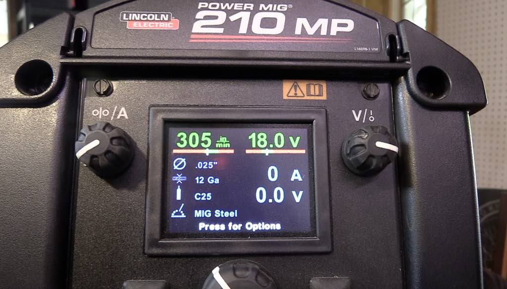

16 ga square tubing. that is supposed to be .063" (1.6mm) but actually measures .058" (1.4mm)
The Lincoln Powermig 210mp has default settings that can be selected by metal thickness but for this video I decided to weld a bit hotter.
Settings for mig welding square tubing .058" wall thickness
The default settings were 17 volts and 240 inches per minute for 16 ga.
That seemed kinda cold to me so I bumped up the settings to 18 volts and 305 inches per minute and with the .025" wire, it was a super smooth arc.
