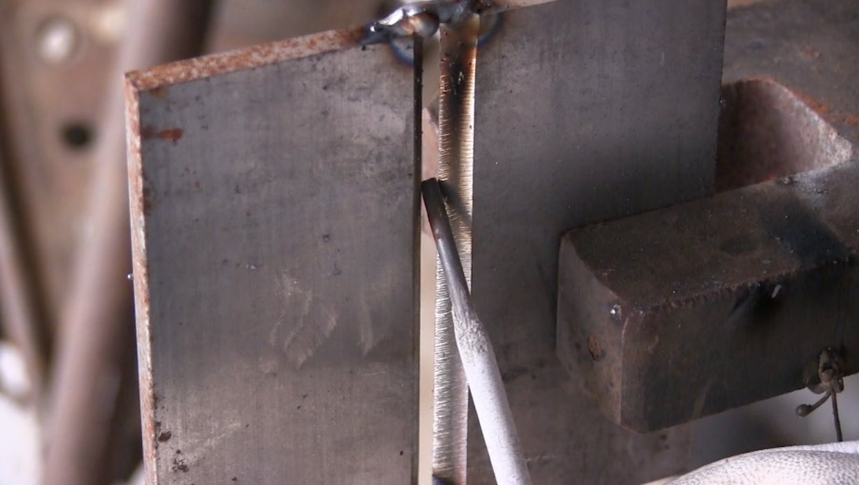

I dont really like mig welding downhill on anything 3/16" (4.8mm)  or thicker...
but MIG Welding pipe roots is one application where downhill mig welding works really well with very little risk of cold lap.
Again, I am not in favor of downhill mig welding using short circuit on anything thicker than 3/16" (4.8mm)  but when you you have clean bright metal with no mill scale, and a 37 degree bevel with a 1/8-5/52" gap, downhill mig does a great job.

Pipe welding codes differ but in the USA codes like ANSI 31.1 usually provide for a bevel of 37.5 degrees plus or minus 2.5 degrees.
A 1/8" gap plus or minus 1/32"
and very little land
When you have a joint like that, a root pass with downhill mig makes a lot of sense.
Figuring settings for a root pass in pipe without using pipe
Fortunately, the same settings that work with plate, will work on pipe.
As long as the joint details are the same or very similar.
I used 1/4" thick plate with a 35 degree bevel and a loose 1/8" gap to develop the mig settings in an earlier video.

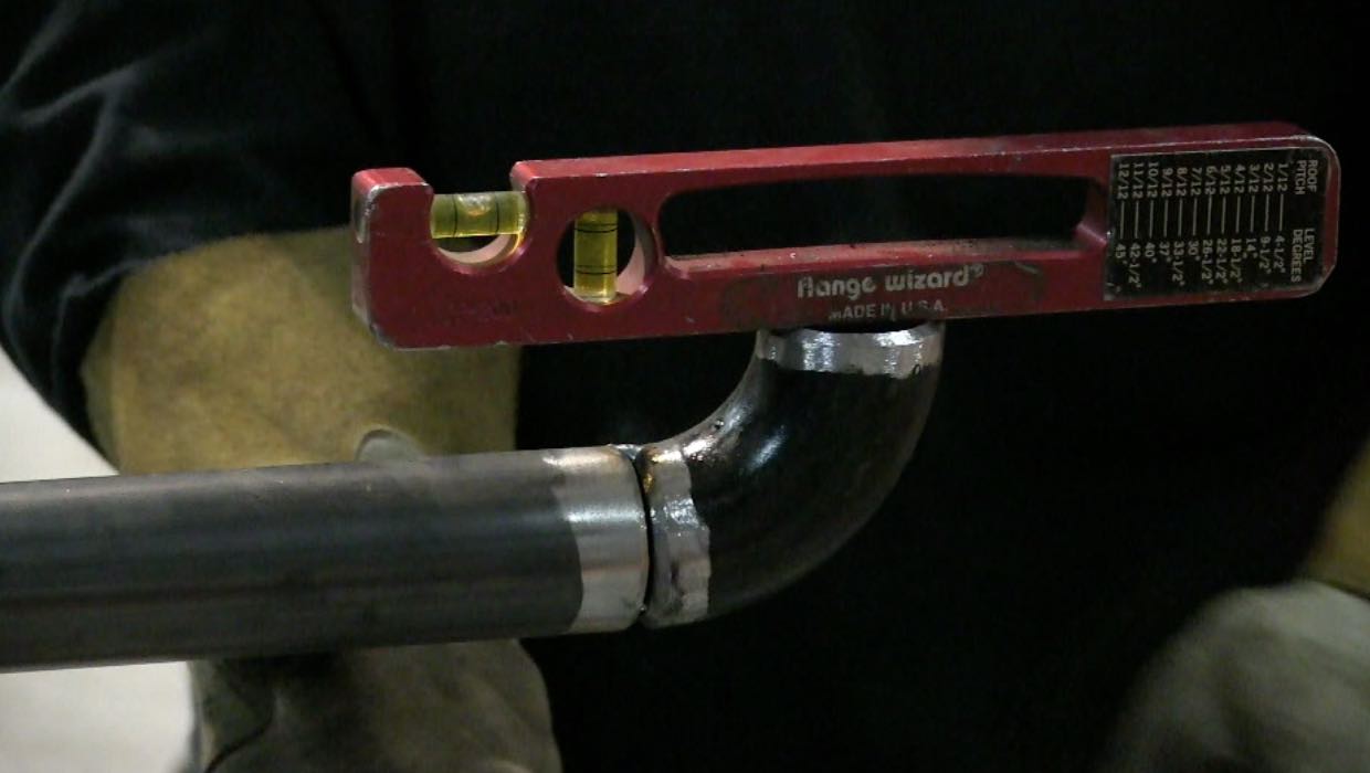

JD beveled a few pieces of six inch schedule 80 pipe so that we could weld a few root passes on the positioner using the stand prop from instagramer @hour.glass_ingenuity
Those same settings worked on 6 inch schedule 80 pipe even though the pipe was much thicker.
18 volts 230 inches per minute
using .030" er70s6 wire

JD had just finished up a hand rail project and had some leftover pipe and fittings so we spun a few of them on the positioner and tried to dial in some single pass settings that would work.
