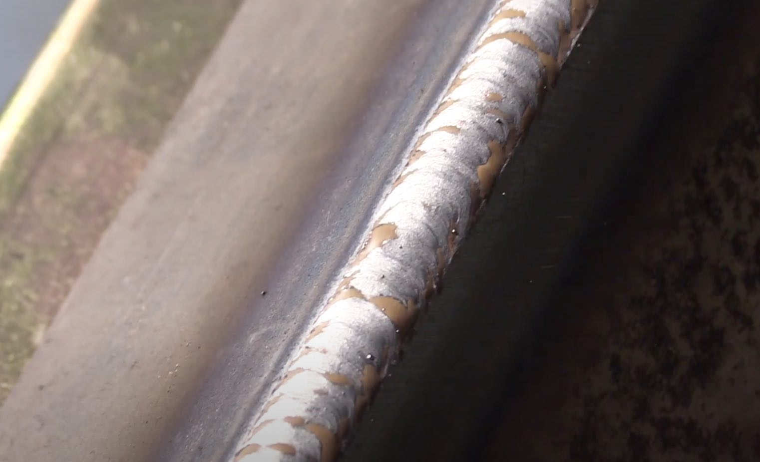

WELD PROCESS = GMAW, SHORT CIRCUIT MIG, GAS METAL ARC, BARE WIRE MIG
METAL TYPE = CARBON STEEL, COLD ROLLED STEEL, AISI 1010
THICKNESS = 1/4” .250, 6mm
WELD TYPE = Fillet weld
JOINT TYPE = CORNER
POSITION = 1F, FLAT
VOLTS = 19.5 volts
WIRE SPEED = 342 IPM
WIRE SIZE = .035"
POLARITY = DCEP
GAS FLOW = 20-25 CFH C25 GAS
CTWD  = 3/8”-1/2"
FILLER METAL = ER70S6
ADDITIONAL SETTINGS = TIPS:A relatively short stickout aka contact to work distance CTWD of 3/8” to 1/2" makes a big difference.
The technique shown is simple drag with very little motion while attempting to keep the arc toward the leading edge of the puddle
