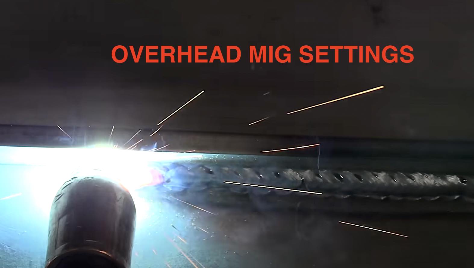

MIG WELDING CARBON STEEL 4F OVERHEAD TEE JOINT 1/4" THICK .035" ER70S6 WIRE
scroll down for settings

4f tee fillet mig 035 WS END.mov
WELD PROCESS = GMAW, SHORT CIRCUIT MIG, GAS METAL ARC, BARE WIRE MIG
METAL TYPE = CARBON STEEL, COLD ROLLED STEEL, AISI 1010
THICKNESS = 1/4” .250” 6mm
WELD TYPE = Fillet
JOINT TYPE =Tee
POSITION = 4F overhead
VOLTS = 20 volts
WIRE SPEED = 333 IPM
WIRE SIZE = .035"
POLARITY = DCEP
GAS FLOW = 20-25 CFH C25 GAS
CTWD  = 3/8”-1/2"
FILLER METAL = ER70S6
ADDITIONAL SETTINGS =
TIPS:A relatively short stickout aka contact to work distance CTWD of 3/8” to 1/2" makes a big difference.
The technique shown is simple serves of V’s that keeps arc on the leading edge of the puddle
