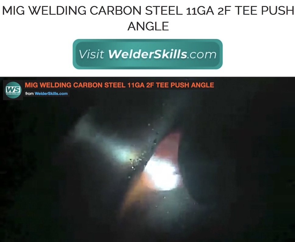

MIG WELDING CARBON STEEL 11GA 2F TEE PUSH ANGLE
19 volts 330 ipm .030” er70s2
WELD PROCESS = GMAW, SHORT CIRCUIT MIG, GAS METAL ARC, BARE WIRE MIG
METAL TYPE = CARBON STEEL, COLD ROLLED STEEL, AISI 1010
THICKNESS = 11GA
WELD TYPE = Fillet weld
JOINT TYPE = TEE
POSITION = 2F HORIZONTAL
 VOLTS = 19.0 volts
WIRE SPEED = 330 IPM
WIRE SIZE = .030"
POLARITY = DCEP
GAS FLOW = 20-25 CFH C25 GAS
CTWD  = 3/8”-1/2"
FILLER METAL = ER70S6
ADDITIONAL SETTINGS =
TIPS:A relatively short stickout aka contact to work distance CTWD of 3/8” to 1/2" makes a big difference.
The technique shown is simple drag with very little motion while attempting to keep the arc toward the leading edge of the puddle
