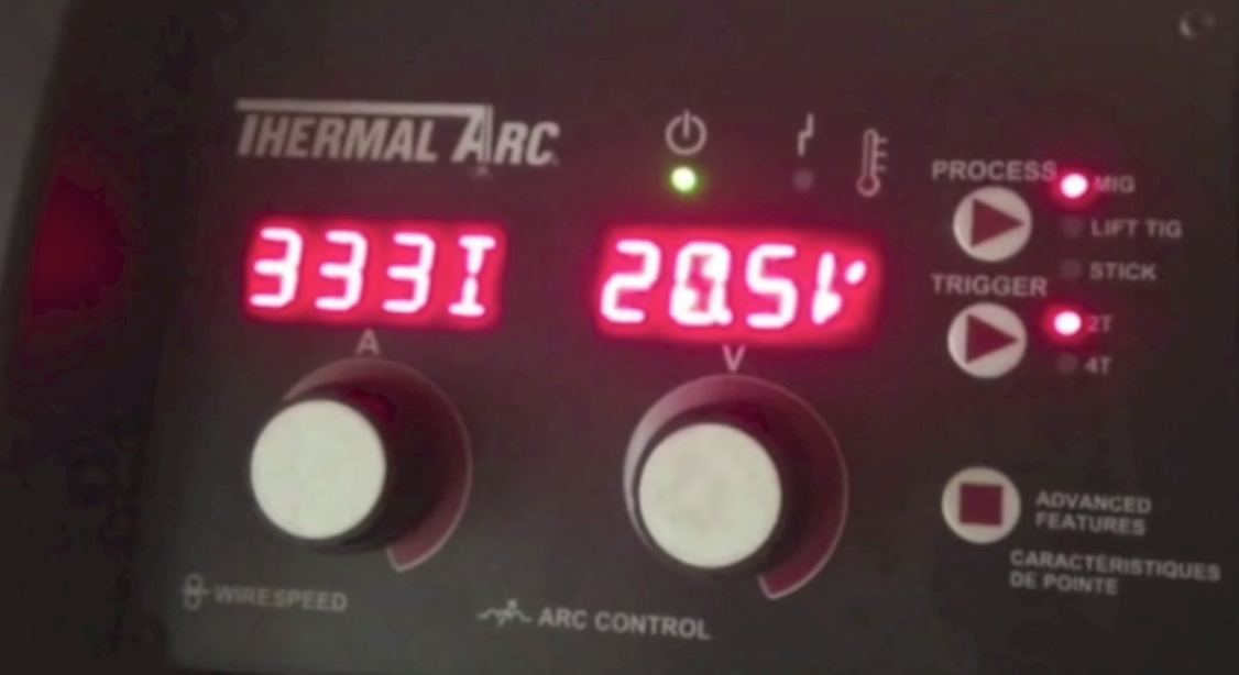

  1. use a short stickout ...like equal or less than 1/2"
  2. dont weld cold just for appearance.
  3. Dont use too much gun angle either pushing or pulling
  4. Use a technique that keeps the arc on the leading edge.
