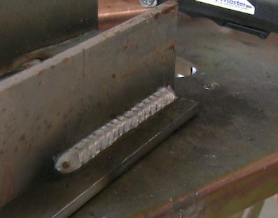

Part of learning Mig welding involves learning about welding techniques that prevent lack of fusion. With short circuit MIG, lack of fusion, or cold lap is always a concern on anything thicker than 1/8" .125" (3.2mm)
Voltage and wire feed settings are very important, but the welding technique used, how you manipulate the arc..., can make a huge difference in the outcome.

But for anything thicker than 1/8" .125" (3.2mm), I like to use a technique that keeps the arc towards the leading edge of the puddle.
So in this video, I tried to demonstrate what can happen when the arc is not kept on the leading edge of the puddle...as well as what happens when the machine settings are right and the arc is kept on the leading edge.
Results of Using the wrong technique for mig welding a fillet weld tee
Using a technique that keeps the arc in the back of the puddle can result in lack of fusion in the root of the joint.
(the root of a tee joint is where the 2 pieces intersect)
The Tee joint shown below was cut using a bandsaw, sanded with 100 grit disc, then red scotch brite, then blue scotch brite pad....Then it was etched using naval jelly rust remover. (wear nitrile gloves)
In the example below the naval jelly etch reveals quite a lot of lack of fusion in the weld on the left.
20.5 volts and 333ipm along with better technique worked a lot better
The welds below were done at 20.5 volts and 333ipm using .035" er70s6 wire
