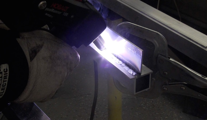

As you see in the video, I had some problems with a Hobart spool gun .
By doing some trouble shooting, I learned that the gas shielding pattern was poor and that was the source of the black soot.
It all made sense after learning that and I added a piece of scotch brite for a diffuser and man did things go better after that.
what about gun angle?
For mig welding aluminum a push angle works best.
And that is mostly because a push angle puts the argon shielding over the arc and other hot areas of the puddle that will oxidize if not properly shielded from the atmosphere.
But what if the position of the weld or other objects in the way prohibit using a push angle?
well, then you have to pull.  But increasing gas flow rate a bit sometimes helps….
and soot is not always a big deal.  On multipass welds, you will want to wire brush all the soot with a stainless wire brush.
