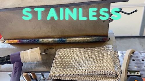

Travel Speed
Your travel speed is one of the biggest factors when it comes to heat input.
And since stainless is not as thermally conductive as carbon steel, heat builds up quickly.
That is why getting a puddle established quickly and getting the puddle moving quickly is key.
Get going in less than 3 seconds. 2 seconds is even better.
Once you get moving, try to maintain a fairly fast travel speed...one where you are not dwelling a long time in one area and overheating the stainless.

Chill Bars to reduce heat buildup
Chill bars made from copper or aluminum can greatly improve results by limiting distortion and discoloration.
For production parts, the time it takes to make tight fitting chill bars, can allow for faster travel speeds with higher heat input without causing carbide precipitation

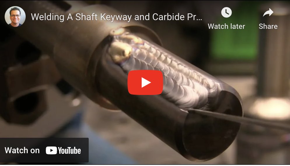

Avoiding Carbide Precipitation
carbide-precipitation-thumb
Carbide precipitation is caused by stainless steel being too hot for too long.
That is why travel speed and chill bars help so much.
Ever heard of 304L or 316L stainless?
The "L" stands for low carbon.
Carbon is kept low because at elevated temperatures carbon and chromium combine to for chromium carbides.  That results in chromium depleted zones that are no longer corrosion resistance.
