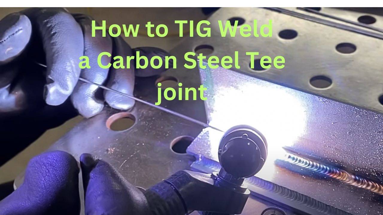

Here is a short concise video on how to tig weld a carbon steel tee joint.

My good friend and Welderskills.com instructor Andrew Cardin is doing the welding for this video and I am behind the camera trying to capture arc shots, hand positions, and wire feeding hand.
Here are the details.
Cold rolled steel 11ga (.125" thickness) (bottom piece is doubled from previous lap joint
DCEN 145-164 AMPS  (normally, amperage would be around 130-145 if the piece on bottom was not doubled )
Jazzy 10 ceramic cup
30 cfh argon flow rate
post flow set to 10 seconds
3/32" 2% lanth electrode
1/16" ER70S6 Filler wire
The relationship between travel speed, amperage, and heat input
165 amps might seem like too much for 11ga cold rolled steel but if you pay attention to the travel speed, you will notice that Andrew not only moves along at a pretty good clip, but he also gets his puddle started quickly and gets moving without hesitating and building up heat.
