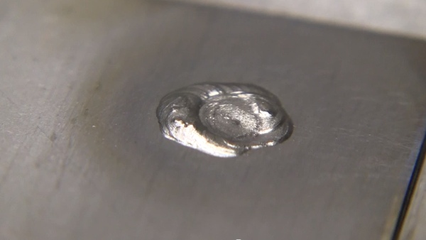

For This weeks video, I decided to use the welding spoon for tig welding some holes in 18ga stainless which is supposed to be .048" ( thats a little over 1mm thick).
Tig Welding Stainless Steel holes with a Harbor Freight Welding Spoon
So in the interest of comparing how well the welding spoon works, I decided to weld one hole without any backing... one using the welding spoon...and one using something called a backup box which is a small purge box that uses perforated copper to supply argon to the back side of things.
As expected, the hole that was welded with no backing sugared on the back side.  Sugaring is a non standard term for "Granulation" which means molten stainless steel that has been severely oxidized.
Sugaring or Granulation is never a good condition no matter how you look at it.
For structural applications, its a stress riser and a place for corrosion to start.  For the food service industry, its a place for bacteria to breed, And for pharmaceutical applications like valves, tanks and piping, its a nightmare....a lawsuit waiting to happen.
Copper backing is not always an acceptable way to weld stainless steel but it is 10 times better than using nothing.
For tig welding holes in carbon steel, it helps speed things up, makes for a better looking weld, and  minimizes distortion. There really is no drawback.
Copper backing also works wonders for backing up the inside of an outside corner joint in stainless steel.
Oh yeah, and the next best thing to a copper block for backing is a thick piece of aluminum.  Works almost as well.
I save every bit and piece of copper I can get because it really comes in handy.  Copper pieces can be softened up by heating to cherry red and then quenching in water.  Then you can bend and shape to fit right against the back side of a weld.
I also keep lots of blocks of thick aluminum around to use for backing and also for chill blocks on stainless sheet metal jobs.
But dont take my word for it.  This is something you can prove out yourself with a small block of aluminum or copper and some thin sheet metal.
A word of caution,....even a little bit of welding time with heat up your aluminum or copper backing so make sure to handle it with care.
Sugaring / Granulation vs properly shielded back side of Stainless steel
