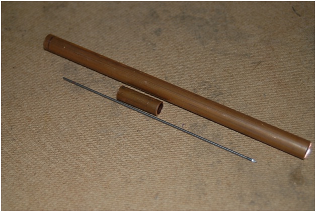

Materials needed for your gas tungsten arc welding electrode holder:
“You need a main piece(larger pipe) a little longer than new electrodes and a cap piece something like 1 1/4” to 1 1/2”. They have to fit inside each other with just a little gap.”

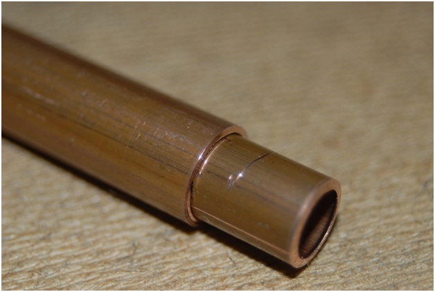

Fit of pieces
This is what you want after deburring the cut ends – a sliding fit with a slight gap. To much gap and this wont work. In metric sizes 12mm and 10mm o.d. pipe works well, these pieces are just that.

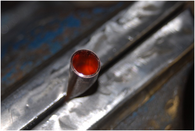

Flatten end
“Flatten the end of the main piece about 1/4” in a vise or something suitable. Squish it tight.”

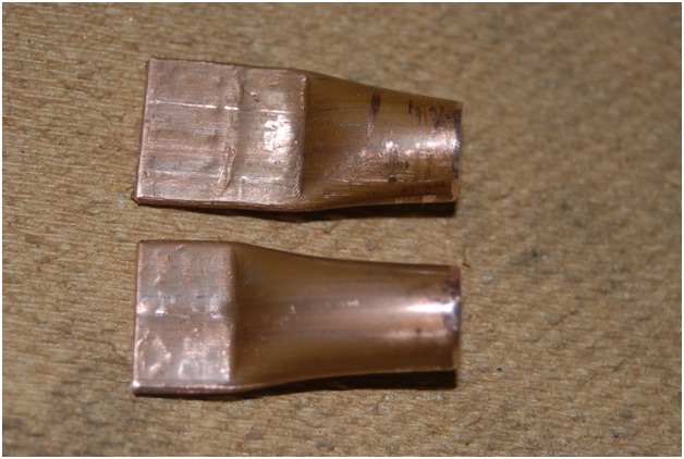

Bad cap Good cap
“Don’t flatten too much of the cap, you need some amount left round(ish) to go inside the main piece. I had to make a new cap since I was a bit too enthusiastic...Can you see how the top cap has been flared too much?”
