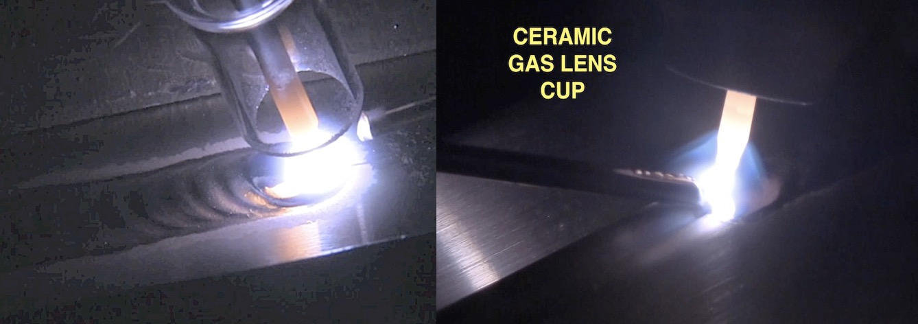

I started using clear TIG cups strictly for filming videos because they help us all see what is happening better in the video.
I didn't really see the point before that.
What I learned was that I could see where I was going quite a bit better.
And when I switched back to a ceramic pink cup, it was kind of like dimming the lights.

The Furick 8 clear cup and TIG finger work great together for TIG welding aluminum.
I started experimenting with clear cups a while back in so that I could make better welding videos where we can all see what is going on better.
I discovered that the clear cups not only help with filming the welding, but they really help me see better.
My eyes are not quite as good as they were when I was 21 and sometimes I have issues seeing a tight crack.
A clear cup acts like a floodlight bulb and lights up the area just enough for me so see way better.
