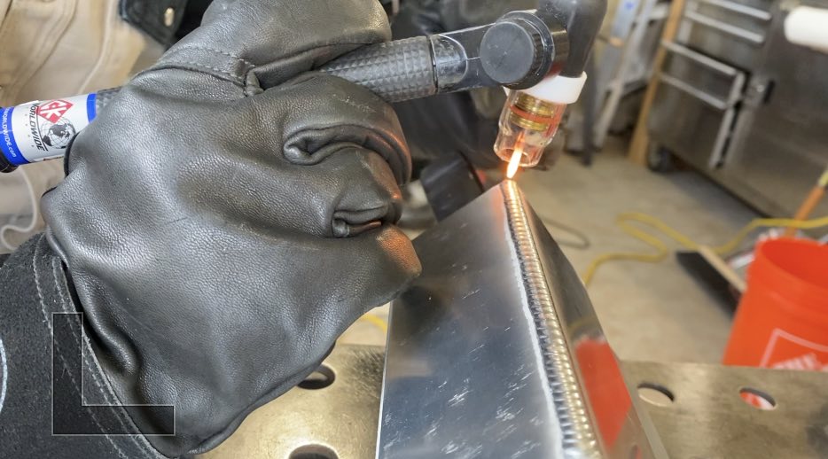

Brad Goodman gives a demonstration on how he pulses with the foot pedal for that stacked dimes look. Brad builds dog boxes, dog feeders, and does a lot of welding for motorsports teams. His customers want the stacked dimes look.
In the video above, Brad uses a Furick #7 clear cup at over 270 amps to test the cups amperage rating
TIG Welding Aluminum Corner Joint with a furick #7 clear cup  - Andrew Cardin

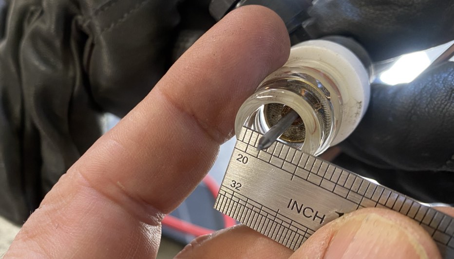

Michael Furick has a brand new cup and its pretty sweet!
It's the clear #7 furick cup and its a great all around gas lens cup for TIG welding both aluminum and steels.
7 furick
The Furick 7 clear cup is rated at 200 amps but that is a very conservative rating.
The reason I know is that I tested it by welding several beads on a thick piece of aluminum on a turntable at over 270 amps with no problems. ( video coming soon)
m200 aluminum corner andrew
