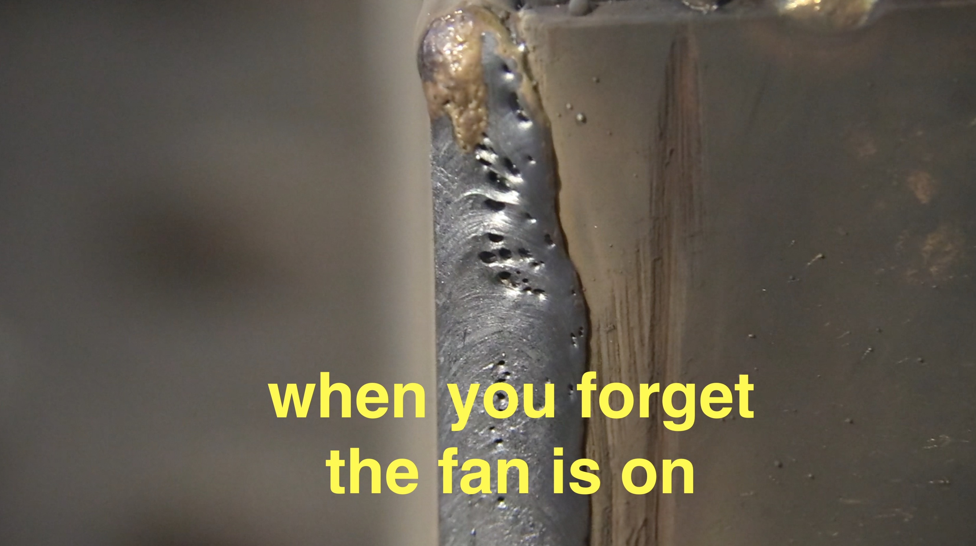

Kick plates made from 11ga x 4" 1010-1020 steel were welded on as well and we were reminded why a big fan blowing on your mig welds is not a great idea.
