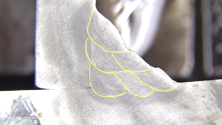

Cut & Etch test comparing Esab 7018 to Hobart
Esab 7018
hobart 7018
