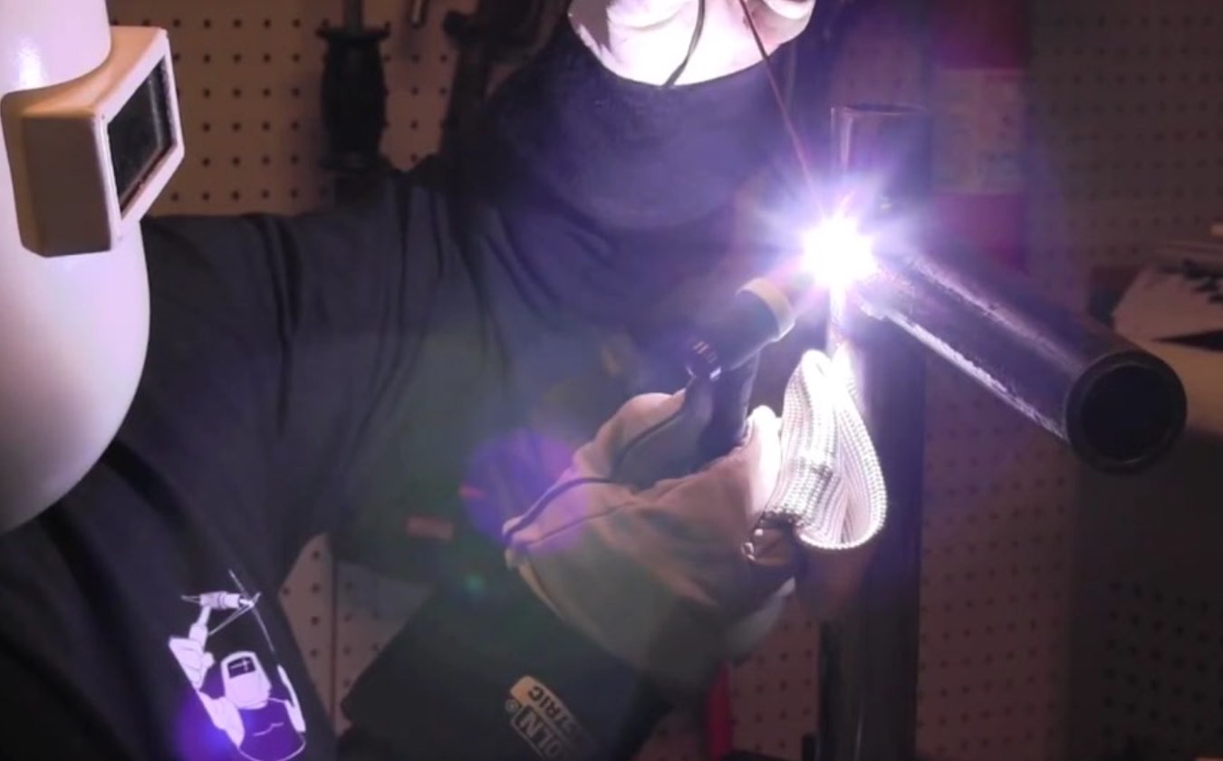

For this video, I welded on hot rolled mill scale plates at 150 amps using both ER70S-2 and ER70S-6 filler rods.
Some of the plates were cleaned pretty well, and some were not….and some were barely cleaned at all.
these were A36 structural steel plates that I was tack welding backing straps on for future videos.
( thank you to Triangle Engineering for donating the plates)
After welding with both ER70S2 and ER70S6 in several different scenarios, I have to say the differences between the two rods are very subtle.
ER70S-2 and ER70S-6
observations ...
  • for some of the joints I welded for this video, there was very little detectable difference in the way the puddle flowed, or in the final weld appearance.
  • when metal was properly cleaned, and when I was not penetrating thru exposing the puddle to oxides, there was very little difference in the way these two rods welded.
  • the area where i did see a distinct difference was when I was penetrating thru the back side without a purge.
  • when welding .048” (1.2mm) thick cold rolled steel, without argon on the back side, there was a noticeable difference in the final appearance of the back side…the penetration side of the weld.
  • When welding over hot rolled steel that had not been cleaned, the ER70S-2 actually had a cleaner final weld appearance….which is something I did not expect.
