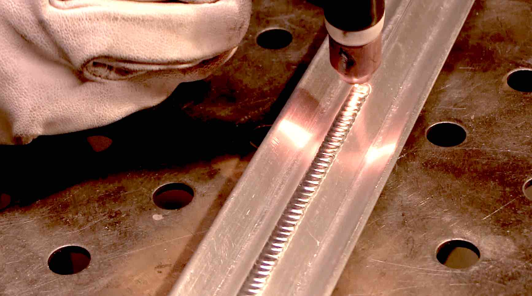

Today, I am getting some practice on an outside corner joint on aluminum.
I have done several videos like this but since I was just practicing, I thought I would bring you along for this one too.
I had some pieces of 1 inch x .120” wall angle so I used that instead of sheet metal.
Aluminum is usually sold by the pound so buying angle is usually about the same price as sheet if the weight is the same.
I got this aluminum angle in 12" pieces from metal supermarkets.
As you might know, I have several tig welding machines that would work just fine for this but I decided to use my Miller Dynasty 280 today along with a 17 style CK worldwide air cooled tig torch with a Stubby gas lens and #6 cup.
Sometimes I like to use the #8 furick pro clear cup because it helps us all to see the puddle but just to show that a smaller cup works fine too,
I used the #6 ceramic cup along with 12-15 cfh argon and a 3/32” lanthanated electrode ( I use 2% lanthanated for everything)
Filler metal used was 4943.  That is not a typo. I didn't mean 4043
4943 is similar to 4043 and wets out just about the same but has somewhat better properties all around except that 4943 can be heat treated after welding to improve strength.

Dynasty 280 settings for tig welding aluminum?
Basic settings for a dynasty 280 could be AC balance to 65-70% and frequency on 100-120hz using advanced square wave.  these are pretty good settings for general tig welding of aluminum.
The Dynasty 280 has tons of advanced settings and sometimes they are very valuable, but for simple joints like this, the basic settings work just fine.

Technique for Tig welding aluminum
Too long an arc length and too much torch angle are probably the 2 biggest mistakes in learning to tig weld aluminum.
Torch angle and arc length are both important.
But fortunately both can vary quite a bit and still work.
Rule of thumb for arc length is one electrode diameter or less.
Torch angle can change due to lots of variables, but trying to limit to less than 25 degrees seems to help most beginners.
Other than that , being very intentional about how far the torch travels in between rod dips, and also being intentional about how much filler metal is added each dip can really make the difference on any type of weld joint.
