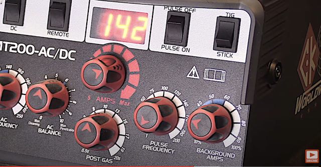

For example the CK worldwide MT200 AC DC tig welder lists duty cycle at 25% at 200 amps for TIG. And 30% at 160 amps for stick welding

Some welders like the ck mt200, have true fan on demand where the cooling fan only kicks on when the internal temp of the machine exceeds a certain level. Then the fan turns back off once the machine cools down.
