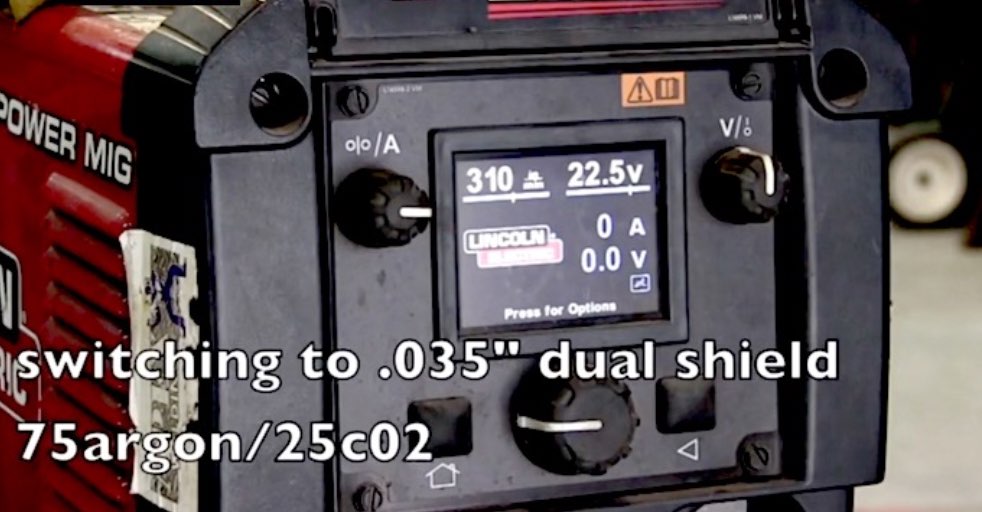

WELD PROCESS = DUAL SHIELD FLUX CORE, FCAW-G ( GAS SHIELDED)
METAL TYPE = CARBON STEEL PIPE
THICKNESS = 3/8”
WELD TYPE = GROOVE
JOINT TYPE = BUTT
POSITION = ROLLED IN JACK STANDS
VOLTS = 22.5 volts
WIRE SPEED = 310 IPM
WIRE SIZE = .035” LINCOLN 71M
POLARITY = DCEP
GAS FLOW = 25-30 CFH C25 GAS
CTWD (STICKOUT) = 3/4”-1 “
FILLER METAL = LINCOLN 71M OUTERSHIELD .035"
ADDITIONAL SETTINGS =
TIPS:A longer stickout aka contact to work distance CTWD of 3/4” to 1” provides best results Using too short a stickout can result in worm tracks
