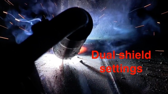

DUAL SHIELD CARBON STEEL SQUARE TUBE 2F FILLET 1/4" THICKNESS
Once and for all pushing vs pulling mig welding
Video of Dual Shield Flux Core vs 7018 Stick Electrode vertical uphill using an Esab Rebel 285
TIG Welder Settings for Steels and Aluminum with Quick Videos Showing settings and results
Dual shield flux core is also known as gas shielded flux core and also FCAW-G.
C25 gas is a popular shielding gas but pure Co2 is also used sometimes.
WELD PROCESS = DUAL SHIELD FLUX CORE, FCAW-G ( GAS SHIELDED), OUTERSHIELD
METAL TYPE = CARBON STEEL
THICKNESS = 1/4”
WELD TYPE = FILLET
JOINT TYPE = TEE
POSITION = 2F HORIZONTAL
VOLTS = 23.5 volts
WIRE SPEED = 370 IPM
WIRE SIZE = .035” LINCOLN 71M
POLARITY = DCEP
GAS FLOW = 25-35 CFH C25 GAS
CTWD (STICKOUT) = 3/4”-1 “
FILLER METAL = LINCOLN 71M OUTERSHIELD .035"
ADDITIONAL SETTINGS =
TIPS: VERY LITTLE MANIPULATION NEEDED.
CTWD (CONTACT TO WORK DISTANCE) SHOULD BE 3/4”-1” A longer stickout aka contact to work distance CTWD of 3/4” to 1” provides best results Using too short a stickout can result in worm tracks
