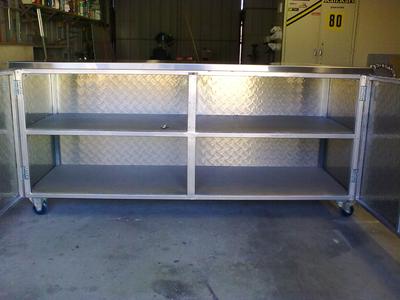

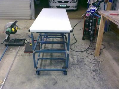

This is a project made for a friend who has a take away business it is a combination of a steel square frame with a a 304 stainless steel top and clad in aluminium. The top is food safe and it lockable. The frame was welded with a MigoMag 220 Amp MIG, the top was welded with a UniMig 140 Amp DC Tig and the cladding was secured with 4mm pop rivets and corner caped.
