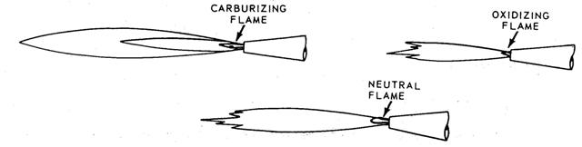

1. What is the function of the fuel gas in an oxy fuel cutting torch process?
The first function of the fuel gas is to provide a medium for ignition. The second function is to combine with oxygen, typically adjusted to a neutral flame setting, and provides the heat to raise the temperature of the material to it’s kindling temperature.
