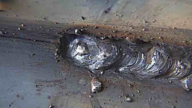

arc-length-in-welding-stick-overhead
Don't underestimate the importance of Arc Length in Welding.
Arc length in TIG welding should be equal to or slightly less than the electrode diameter.
Same with Stick welding.
But for short circuit mig welding, arc length is mainly determined by stickout and of course wire speed....but assuming your wire speed is set correctly, then stickout has a great affect on the bead

The Importance of Arc Length in TIG, MIG, and SMAW Welding
I can’t stress this enough: arc length is one of the most critical factors in achieving high-quality welds. If your arc length is wrong, you’ll struggle with poor penetration, excessive spatter, contamination, or weak welds. Let’s break it down by process:

MIG Welding (GMAW) short circuit mig – Arc Length Affects Amperage output, Spatter and Bead Shape
Ideal Arc Length aka stickout: Around 3/8" depending on wire diameter and voltage.
Why It Matters:
✅ Controls spatter – A short, controlled arc minimizes excessive spatter.
✅ Ensures good penetration – The right arc length/stickout helps maintain consistent amperage
✅ Consistent bead profile
What Happens If Arc Length Is Too Long?
🚫 Excessive spatter
🚫 Weak penetration, risk of lack of fusion
🚫 Inconsistent bead shape
What Happens If Arc Length Is Too Short?
🚫 The wire can stub into the weld pool, leading to lack of fusion and an erratic arc
🔥 Instructor Tip: Make sure the contact tip is not recessed back in the nozzle and Learn to listen to the arc! A proper short-circuit arc sounds like a steady "sizzling bacon" sound.
