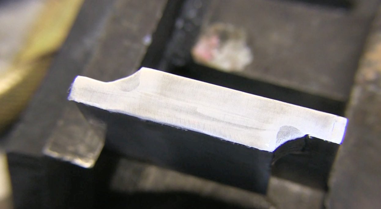

What is Advanced AC Pulse and how does it compare to AC Waveforms
Advanced AC Pulse alternates between DCEN and AC and it provides deeper penetration than all the other AC waveforms.
I set the pulses per second to 2pps , the pulse time to 50%, and the background current to 100% because the background current is the DCEN pulse and I wanted maximum heat input and penetration.
When I cut, polished, and etched to compare the AC waveforms I didnt see much difference at 175 amps.
But using the same 175 amps and advanced pulse, penetration was much deeper.
Lap joint on 1/4" (6.2mm) 6061 aluminum using advanced AC pulse
I increased amps to 200 for the lap joint used 3/32" (2.4) 2% lanthanated electrode and 1/8" (3.2mm) 4943 filler metal.
Using 2 pps, I dipped filler rod every other pulse.
A quick cut and etch revealed good penetration into the root.
