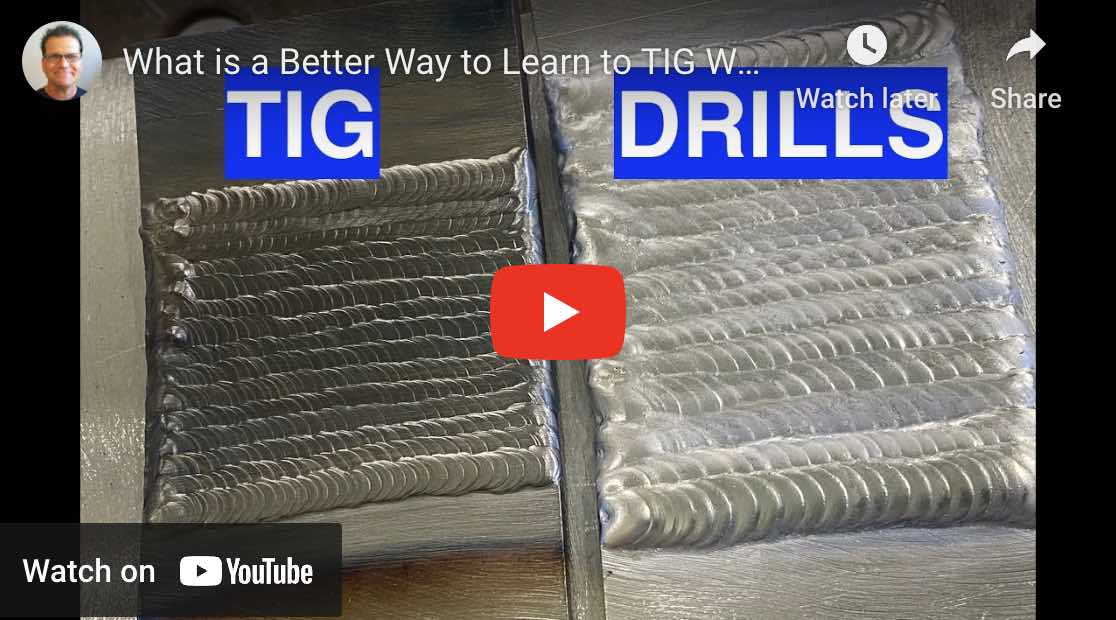

Tip #3 Get a good many pieces of practice metal around 1/8" thick or so ...both carbon steel and aluminum. and devote plenty of time to welding beads with and without filler metal.
Don't get stuck only welding carbon steel.
better-way-tig-weld-thumb
Carbon steel is a great way to start off but switching back and forth from carbon steel to aluminum has proven to help shorten the learning curve and avoid building bad habits.
Its easy to get lulled into a rut when welding bead after bead on carbon steel but switching back and forth every few beads from carbon steel to aluminum will keep you on your toes and require your full attention to details.
Practice padding beads just like you see in the video above until it feels natural and your beads are uniform. There is no need to advance to lap joints, tee joints, or square tubing welds until your beads are uniform.
