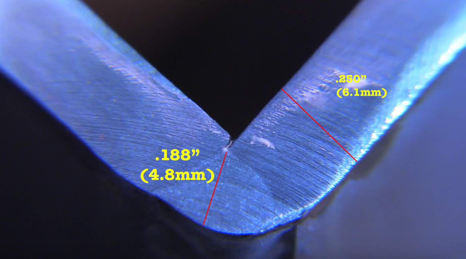

Cut and etch tests showed the results
Cut and Etch results
single pass with slight gap
2 passes with overlap
2 passes
The reason I like to do Cut and Etch testing on welds is that is the only way to really prove out a technique or procedure.  The cut and etch test really correlates what you think you see to what actually happened.
I saw really quickly just how much affect the fitup has on an outside corner weld.
I fit the joints up corner to corner and with a slight gap..but as I progressed along the joint, as often happens, the weld metal shrinkage pulled the 2 pieces together and actually caused a bit of overlap.
when there is any overlap on an outside corner joint, it really changes the overall cross sectional thickness of the weld.
Engineers know that a fillet weld is not a full strength weld and typically dont utilize fillet welds where a full strength weld is required.
Even so, its important to consider just how much difference a fit up makes in an outside corner.
Any overlap reduces the cross sectional thickness of the weld a lot.
That is why you will often see a weld symbol that also requires welding a fillet weld on the opposite side of an outside corner joint....to provide adequate strength.
So a fitup corner to corner with no overlap, along with a 2 pass weld at 75 amps worked best for me.
