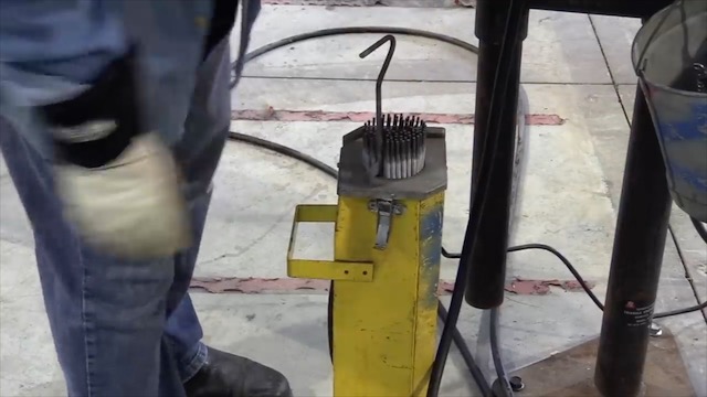

Are 7018 rods Low Hydrogen rods?  and do they need to be kept in a Rod Oven?
7018 rods are engineered to be low hydrogen rods.
Once a can of 7018 rods is opened, the rods need to be kept in a Rod oven in order to preserve the low hydrogen characteristics.
So once a low hydrogen electrode is exposed to air, and not in a rod oven, there are only a few hours before that electrode is no longer a low hydrogen electrode.
click here to see  more stick welding videos
Most rods strike better and weld better if they have been kept in a rod oven
rod-oven-7018
But what about applications where a low hydrogen rod is not even required?
Are you any worse off welding with a 7018 that has not been kept in a rod oven than you are using a 7014 rod?
I dont think so.
Using a 7018 rod that has not been stored in a rod oven is no worse than using a 6010, 6013, or 7014 rod.
I like 7018 rods.  I can see and distinguish the puddle better than I can on 6013 or 7014 rods.
So I dont hesitate to use 7018 anywhere I would use the those other rods...even if those 7018 were left out for days, weeks, or months.
But if I am doing critical work or welding that needs to comply with structural welding codes like AWS D1.1, I use 7018 rods that are fresh out of the can or kept in a rod oven.
