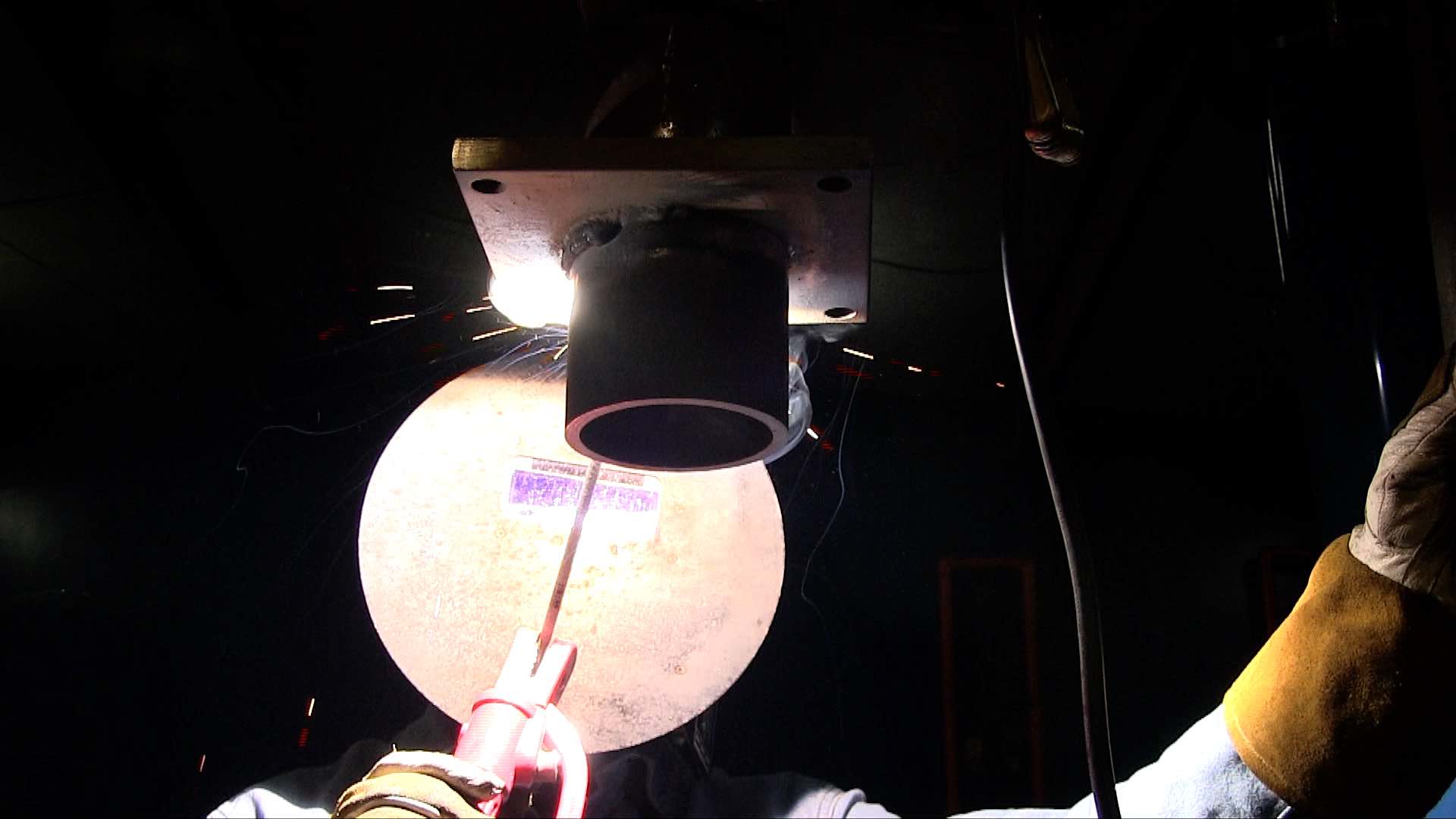

In this video, We welded Tube to Plate using 5/32" 7018 at 175 amps.
Here is the key to overhead stick welding with 7018...
Set the amperage high enough so that the rod will not stick even when you hold a really tight arc...
Then hold a tight arc.
175 amps on a lincoln 210mp with an arc force setting of 10 worked pretty well on this tube to plate 4f joint.
The same techniques used for an overhead tee joint will work for this overhead tube to plate joint.
The only real difference is that the part is round.
Pipe and tubing require body repositioning while welding and that is a skill that should be practiced.
The main things to consider when overhead stick welding with 7018 are:
  • Amperage and Polarity...for this weld we used 175 amps on DCEP with arc force set to 10. (amperage range for 5/32" 7018 is 130-210)
  • Arc Length was as tight as practical without sticking
  • Rod Manipulation was minimal.  The first pass was a drag pass.  2nd and 3rd pass seemed to go in better with some slight manipulation.
  • Travel Speed was just slow enough to fill and avoid undercut

main takeaways ...
Setting the amperage high enough but not too high.  Too much amperage will cause arc blow and undercut.
Use minimal rod angle
Hold a tight arc
