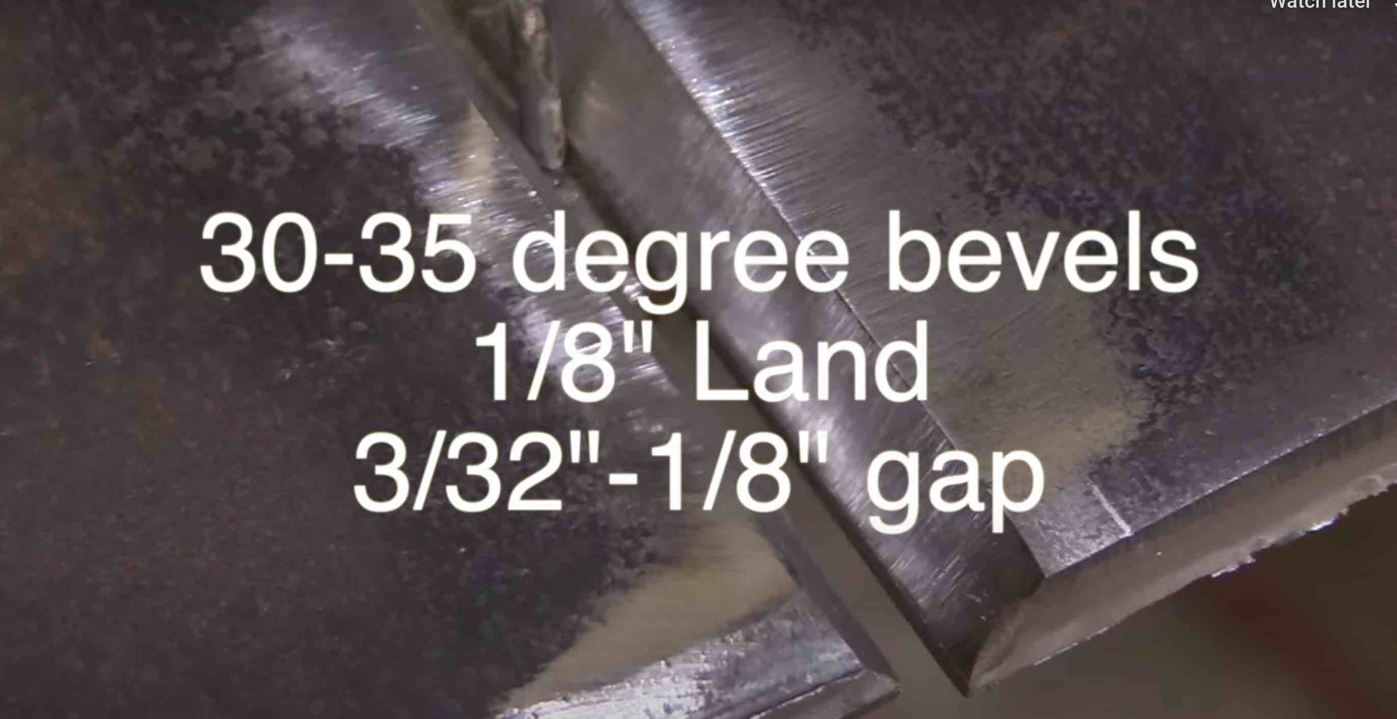

2g Root pass with 6010 1/8"
The bevel angle, land, and gap make a big difference on a root pass using 6010.
When you practice a plate like this, its important to use the same bevel angle, gap, and land as the test you will take.
2g-plate-6010-root-fitup
The amperage for the root pass was set to around 85-90 amps using a 1/8" 6010 electrode.
2g Fill and cap with 7018 3/32"
For the 3/32" 7018 fill and cover pass, amperage was 85-90.
This weld could easily be done using 1/8" electrodes and for a weld test, the welding procedure might either give the option of either 3/32 or 1/8 7018 or it might specify a diameter.  Always read and follow the weld procedure when taking a weld test.
A 2G plate test is mostly a practice weld required by welding schools and its a great way to get better at 6010 roots before moving on to more difficult positions.
There are companies that require A 2g plate test  along with 3g and 4g plate tests to qualify for all positions.
