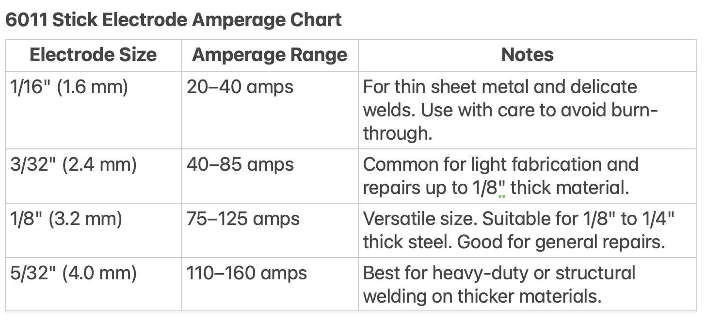

  • 6011 stick rods will work on most of the small inverter stick welders where  6010 rods will not.
  • 6011 stick rods work on all polarities and being able to weld with AC eliminates arc blow (arc blow is what happens when magnetic forces build up and cause the electrode to burn unevenly)

I decided to test some welds in both 1/8" (3.2mm) thickness and 3/16" (4.8mm) thickness and the results were eye opening.
The 1/8" rod on 1/8" thickness did ok but using 5/32" (4mm) 6011 on 3/16" (4.8mm) thick material was a different story.
The biggest problem was the concavity of the fillet weld.
the weld looked ok but when I measured the throat of the fillet weld it came up short.
And when I did the cut and etch test, it revealed an actual throat size that was surprisingly thin.
Downhill welds are typically much more concave than uphill welds.
Not a problem for thinner metals but trying to get a sound and strong weld on 3/16" thick metal going downhill might require 2 passes.
