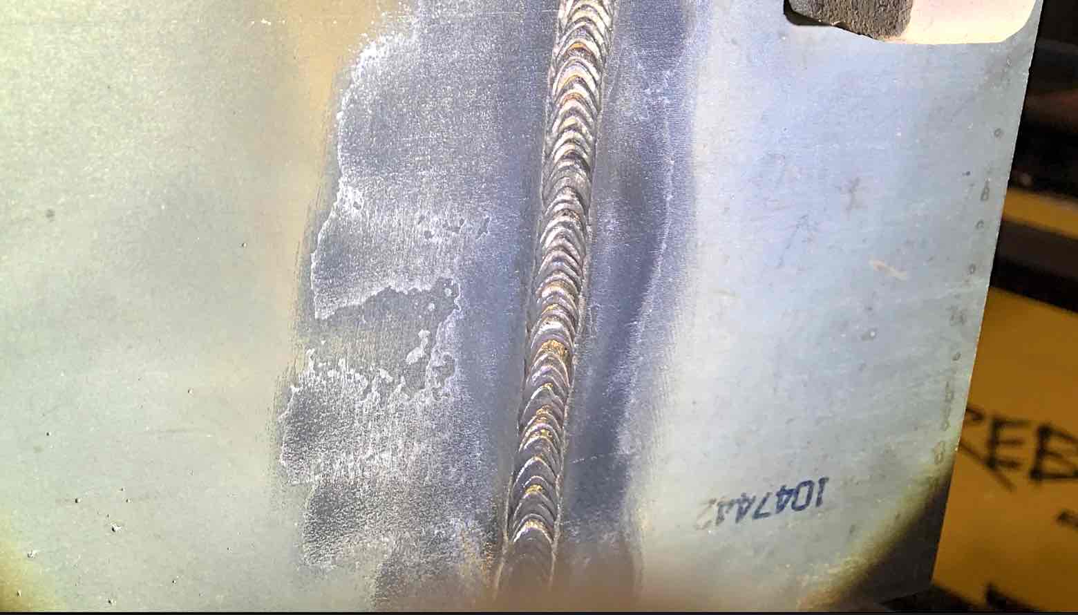

Fitup for 6010 downhill root practice
The plates are from Triangle engineering. they have a 30 degree bevel on them and are coated with a protective coating that can be welded over.
For this video we used a 1/16" gap and a 1/16" land.
It is important to get a good even fitup with no hi-lo (mismatch) and an even gap from end to end.
The tack welds will shrink the gap so make sure to gap the plates using a slightly larger spacer so that when the tack welds shrink, the gap will be 1/16". ( and if the gap is less, you can always open it up using a cutting wheel on a grinder).
Amperage for the 6010 downhill root
Amperage was set to 80 amps but was increased to 90 amps.
this will vary somewhat from machine to machine.
and also with fitup.
If your gap is more than 1/16" use less amps..and if your land is less than 1/16" , use slightly less amps.
and more amps if gap is tight but again...if gap is really tight, open in up with a grinder and thin wheel.
