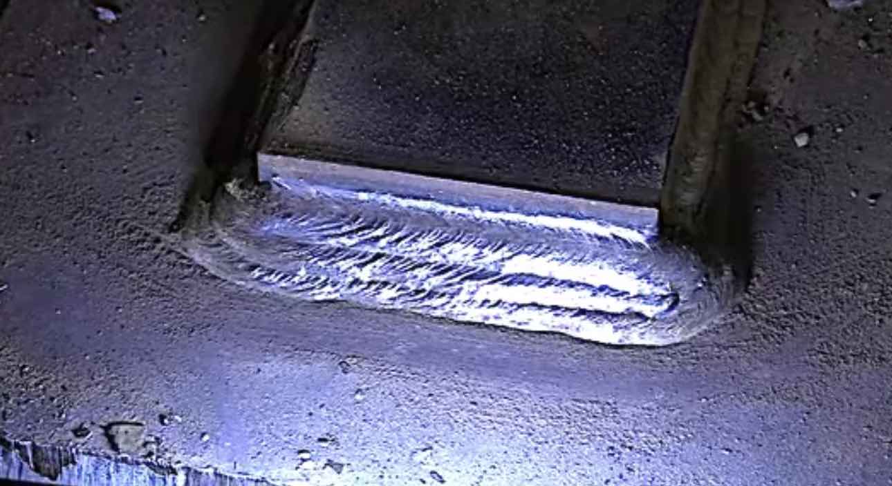

3/16"  7018  amp Settings  2f  FILLET WELD
multiple passes
scroll down for detailed settings

WELD PROCESS = SMAW, SHIELDED METAL ARC WELDING, STICK WELDING
METAL TYPE = CARBON STEEL A36
THICKNESS = 1"
WELD TYPE = Fillet weld MULTI PASS
JOINT TYPE = TEE/LAP
POSITION = 2F
AMPS = 230 AMPS
POLARITY = DCEP
ELECTRODE = 7018 3/16"
ADDITIONAL SETTINGS =
TIPS:SET THE AMPERAGE HOT ENOUGH TO NOT STICK THE ROD WHEN YOU HOLD A TIGHT ARC…THEN HOLD A TIGHT ARC.
DIFFERENT MANUFACTURERS ELECTRODES REQUIRE SLIGHTLY DIFFERENT AMPERAGE SETTINGS.
ANY SUCCESSFUL DEMONSTRATION DISPLAYING AMPERAGE SHOULD GET YOU IN THE BALL PARK.TWEAK AMPS FROM THAT POINT AND ADJUST ARC CONTROL TO FIT THE SITUATION
