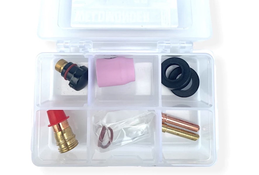

Our New 8 pro combo 1/16" kit for 17 style tig torches...
Our 8 pro combo kits for 17, 18, 26 torches come in a pocket size tackle box full of these parts:
  • Clear Furick 8 pro cup
  • Ceramic weldmonger 8 cup
  • furick 1/16 stubby gas lens
  • furick 1/16" wedge collet
  • ck 1/16" split collet
  • o rings for clear 8 cup
  • short back cap
  • 2 heat insulators..one works best for ck tig torches and one is for all other brand tig torches....just to make sure you have the best fit possible.
