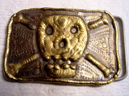

So I made this buckle for him to wear when he plays gigs. It was a risk because a homemade belt buckle from Dad is not exactly the coolest thing for a 22 year old hard core guitar player to talk about.
But I made it anyway. Hopefully it will grow on him.
Wanna know how I made this custom belt buckle?

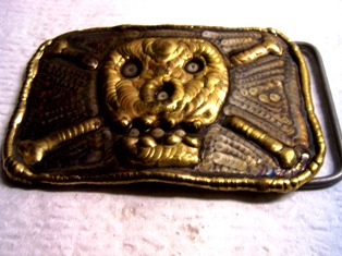

I started with a small piece of 304 stainless about .063" thick. Thicker would have been better because it wants to warp with all the welding.
I sanded a radius on the corners with a belt sander. and then I put it in a vice and put a slight curve in it
I drew an outline of the skull and crossbones with a pencil and then went over it with a 1/8" carbide burr so I could see it while welding.
I used 1/16" diameter aluminum bronze filler wire to weld the skull and crossbones. Using a Miller Syncrowave 250 set on Alternating current…like for welding aluminum.
Now normally I wouldn’t weld stainless steel on A/C but for using aluminum bronze for welding art, it works really nice and leaves the bronze weld beads with a gold shiny appearance.
Welding it on DCEN comes out dull.
If you have A/C balance or if you are using an A/C DC inverter like a Miller Dynasty 200DX, Lincoln invertec v205t, or an Everlast Tig welder, you would set the A/C balance high. …10 on a syncrowave, or up to 90% on an inverter.
It doesn’t take much heat to flow aluminum or silicon bronze on stainless, so use just enough heat to move the puddle. Its all about looks here,,,not penetration.
I let it cool very often, in fact, I dunked it in a bucket of water every bead or two making sure to leave it warm enough to evaporate all the water so it would be dry when I fired back up.
I didn’t have all day to wait for it to cool off and wasn’t worried what quenching would do the the microstructure.
This is welding art …all that counts is looks.
After I got the skull and crossbones done, I filled in the spaces with weld beads pulsing the foot pedal to leave distinct ripples and not using any filler rod.
Once the front was done, I just made some hardware for the back out of 3/16" tubing and welding rod. I puddled the end of the post with a little ball so it wouldn’t slide out of the belt holes.
