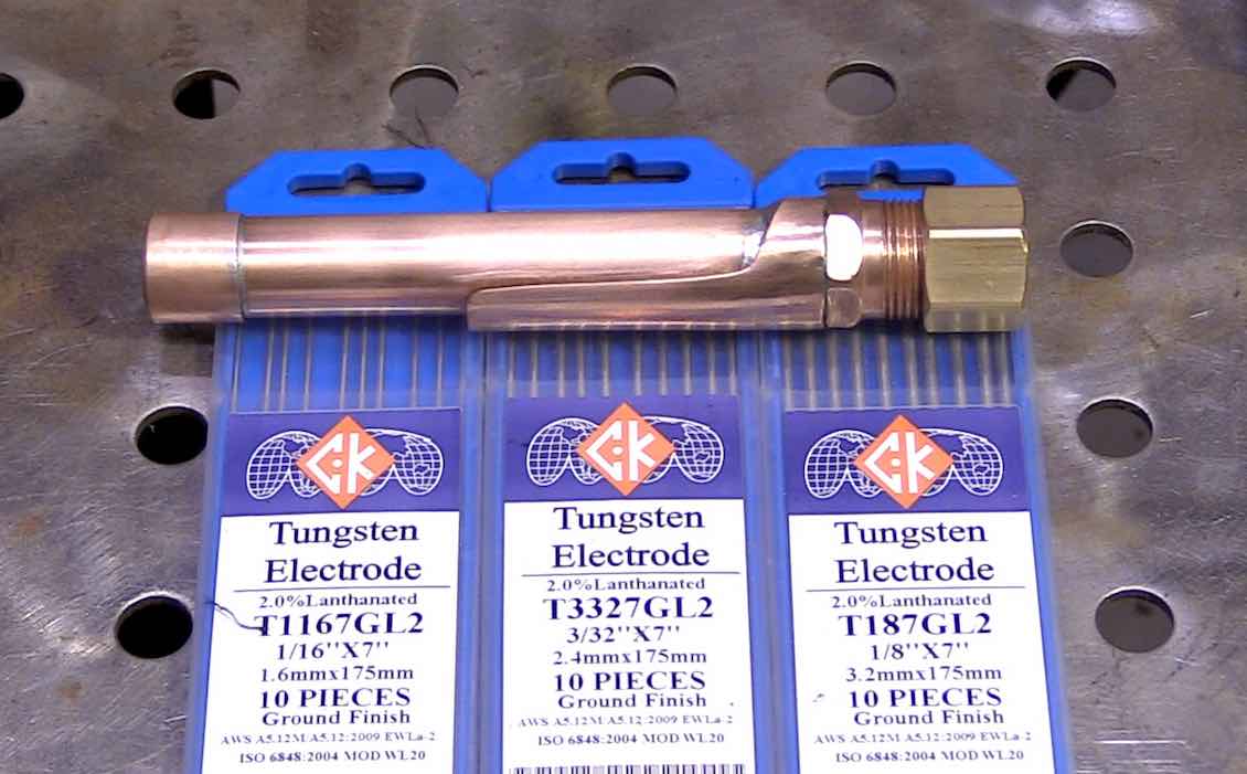

In this video, I made a pocket tungsten holder out of some leftover 3/4" copper pipe.
A really simple version of this pocket tungsten holder can be made with a piece of pipe and 2 end caps but I added the threaded fitting on one end to avoid any possibility of dumping sharp electrodes out when crawling around in the field.
I started by cutting a piece 6 inches long and then soldering an end cap on.

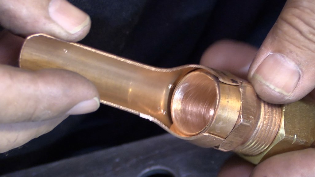

Then I cut the pocket clip by freehand drawing a section of pipe and making the clip part 7/8" wide.
The entire pocket clip was around 3 inches long and the part that extends over your pocket was over 2-1/2" so that it will stay put.
Then I split the clip and also cut a spacer piece and also split the spacer.

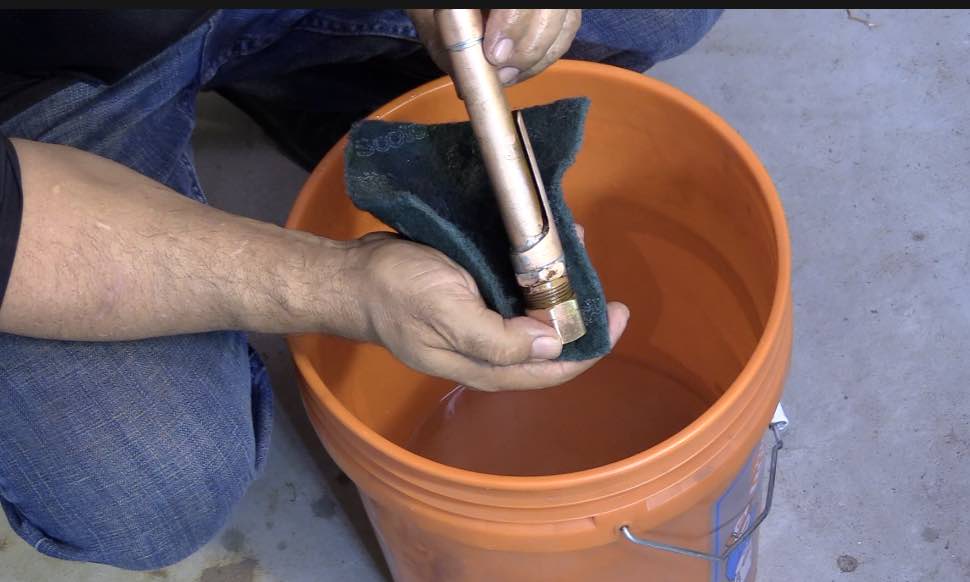

I tapped and massaged them lightly with a hammer to make them fit decently and then fluxed and soldered everything together all at once.
After soldering, I rinsed in hot soapy water and rinsed the inside with acetone.
I also used a cotton buffing wheel with some polishing compound to make a matte finish.
Copper will tend to darken and achieve a certain patina anyway so I didnt take the time to get a really shiny finish.
since I already had the copper pipe, all I needed to buy were the fittings and I think my total cost for this pocket tungsten holder was around 10 dollars...and I finished the project start to finish in about an hour.
