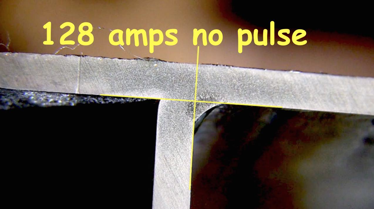

I welded one tee joint at 128 amps with no pulse.  I set the main amps to 131 amps but I didnt quite use all of it and maxed out at 128.

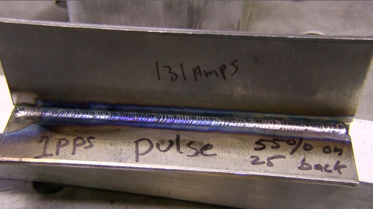

The next tee joint was welded at 131 amps with the foot pedal floored and using 1 pulse per second,  55% pulse time, and 25% background current.

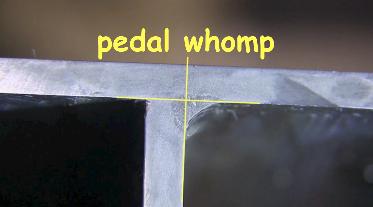

The 3rd tee joint was welded using the "pumping the pedal" or "pedal whomping" technique.  I floored the pedal for just long enough to add filler, and then backed off and let the puddle cool to around 1/3" the size.

All 3 joints had adequate penetration but the straight current weld with no pulse had slightly less penetration into the root.
Why is that?
I am guessing that travel speed had a lot to do with it.
The slower the travel speed the more heat input.
Notice the difference in the heat tint of the 3 joints.
The pedal whomp joint had the slowest travel speed and also displayed a lot more heat tint than either of the other joints.
