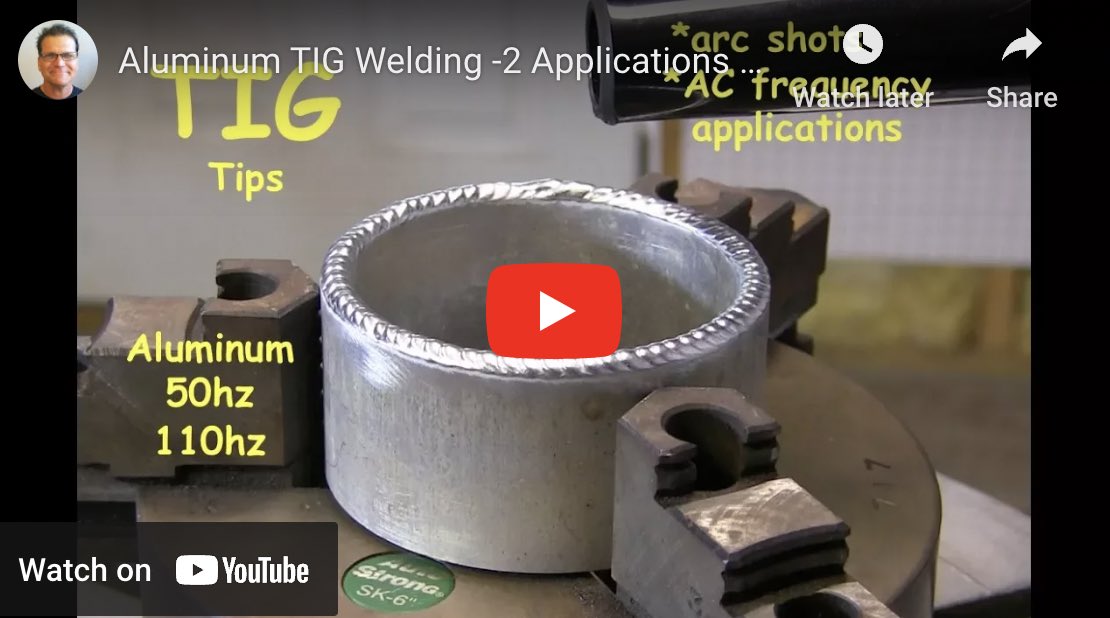

Now we need to talk about AC frequency on tig welder inverters.
remember when we said that alternating current is actually dcen and dcep swapping back and forth rapidly?
Well just like the ac balance lets us tweak the ration of dcen and dcep, ac frequency lets us tweak how slow or fast the current alternates.
In the first video of this series, there was a demo where you could actually hear the pitch of the buzz change when we increased the frequency of the ac.
The lower the setting , the lower the pitch. Think of it like this….a low frequency like 30hz is kind of like the way a Harley Davidson runs, and a higher frequency of 250 hz is more like a rice burner at high rpm.
Alternating current Electricity from the power company comes to us at 60 hz in the US. (hz is the frequency it swaps polarity)
Old school transformer tig machines don’t change the frequency of the ac current. So you are welding with 60 hz ( 50 hz in some countries)
With newer inverter tig machines , you are not stuck with 60 hz and in fact you can adjust it all the way to 200 hz or even higher on some inverters.
So what does that mean to you? Well maybe nothing.
Some people might actually prefer welding at 50- 60 hz just like some people like the way a Harley Motor lopes rather than the pure performance of a high rpm Honda Ninja.
But the results are kind of hard to ignore.
One bike is obviously faster than the other. But speed is not the only reason people buy motorbikes.
Sorry for Getting off task with all these metaphors…
Setting the frequency higher focuses the arc cone to a stiffer and more pinpointed arc. But there is a sweet spot here too. I think the sweet spot lies somewhere between 100-120 hz.
If you just want another setting to set it and forget it, go with 100hz.
Really high ac frequencies seem to be more for increasing travel speed in automated applications like aluminum tube mills where travel speed is measured in feet, not inches.
For the kind of manual welding that you and I do, you will rarely need more than 150 hz for anything.
