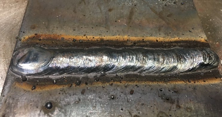

6013 bead with amperage, arc length, and travel speed pretty good
this bead was welded with 115 amps.
when amperage is within scope along with all the other variables, the 6013 bead comes out pretty good with uniformity. notice there is some spatter even though everything was in scope. Some electrodes are better than others and I was using some I got from a big box store and spatter just seem to want to happen no matter what I did.  I bet there are much better 6013 electrodes available like from Esab, Lincoln, or Hobart.

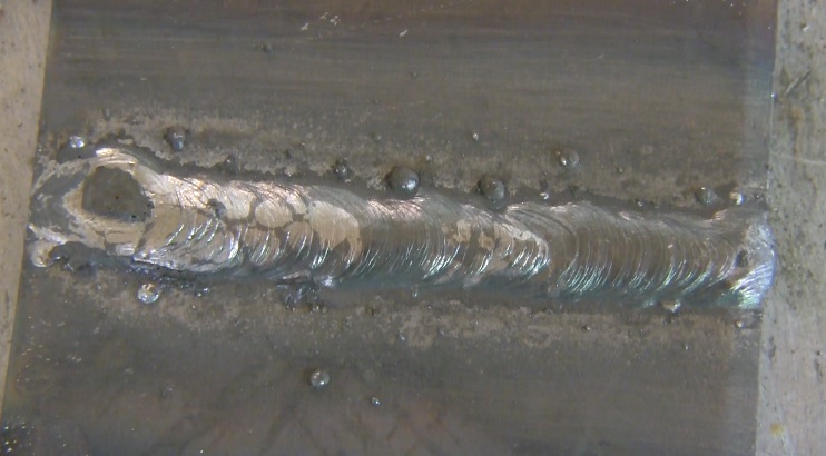

arc too long...stick welding with 6013
In the flat position, you can get away some long arcing.
But when you shift gears and start welding vertical or overhead, a long arc will be a problem.

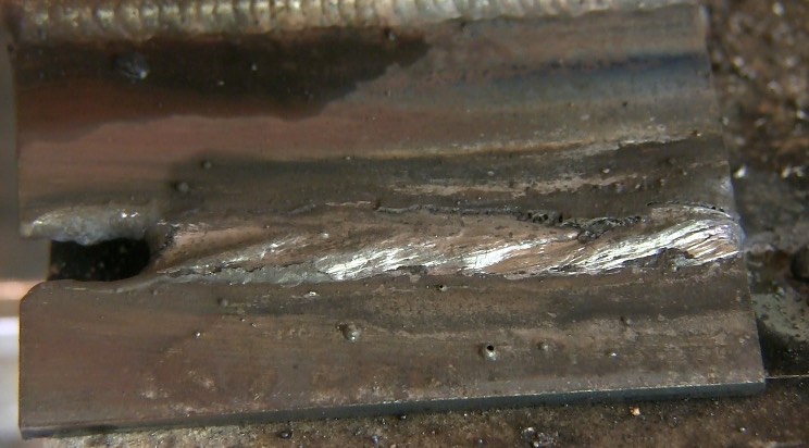

too much amperage
Stick welding with 6013 1/8" at 150 amps  usually only works on thicker metal. I blew a hole in this 11 ga piece.
