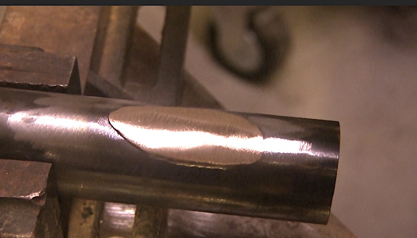

TIG Brazing is very useful for applications like the one pictured below where a metal is worn very thin.
Because of the large difference in melting points between carbon steel and silicon bronze filler metal, very thin base metal can be overlayed without melting away the base metal.
silicon bronze overlay of worn area
