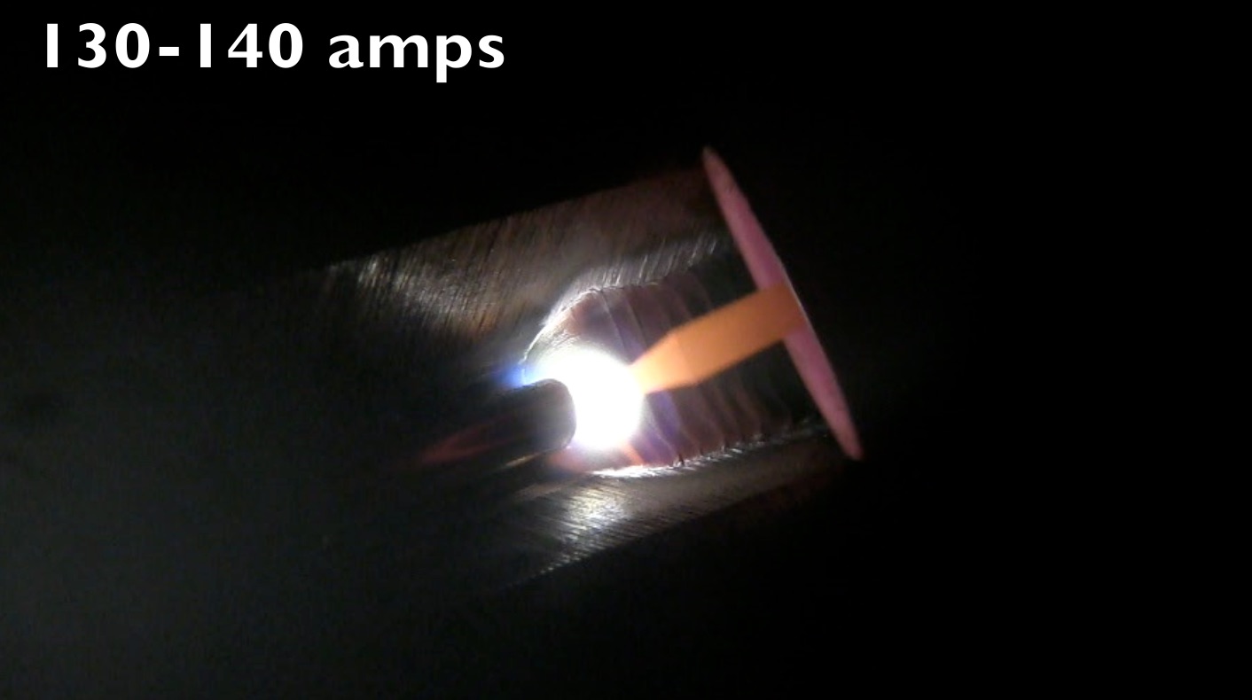

Also, I am welding the second pass over top of an open butt root. Its often called the "hot pass"...but sometimes, the same amperage is used as the root.
Amperage needed for the second pass is determined by several things...

The hot pass in tig welding adds more metal to make it unlikely for melt thru to occur once stick welding is started.
In addition to adding more metal...One of the main goals of the hot pass is to not negatively affect the root pass.
In other words, you dont want lack of fusion between the root pass and the hot pass, but you dont want to melt thru either.
Melting thru often times causes suck back.
Suck back is when the root is remelted and drops below flush...or even below the surface of the rest of the root.
its something that can fail  X ray...and inspectors dont like it either.
Here are a few things  that affect how much amperage is needed for a good hot pass that does not melt thru or suck back:
  • how much metal was deposited in the root pass...if a very thin layer of metal was deposited, the same amperage will probably be enough
  • what position the weld is in... for example, more amperage can be used if a weld is done in flat position vs vertical.
  • the included angle of the bevel...ASME codes usually favor a 75 degree included angle but there are other joint configurations too. for example, on heavy wall pipe, sometimes a J bevel might be used and that might even required 2 hot passes at low amperage to avoid suck back
  • how fast you can travel...if you are proficient at walking the cup, you can probably get away with higher amperages than someone who cant walk it out as fast as you
Personally, I usually play it safe and either use the same amperage as I used on the root...or only slightly higher.
