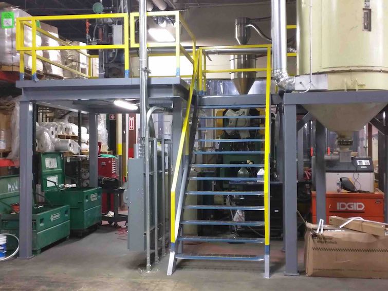

We used the MP210 for welding; fire exit staircase and platform, a mezzanine over a plastic injection machine, high pressure airline piping, small stainless, aluminum handrail repair, large hopper stand, etc....
We used everything this machine had to offer (except the tig foot pedal). Everything from .025 70s-2 to aluminum spool gun to 7018 stick to .035 71m outershield fluxcore (my favorite!).  i have put this machine thru its full range and it has not ever let me down.

See the images below for the type of work JD @ Apex Welding has done using his Lincoln Powermig 210mp
