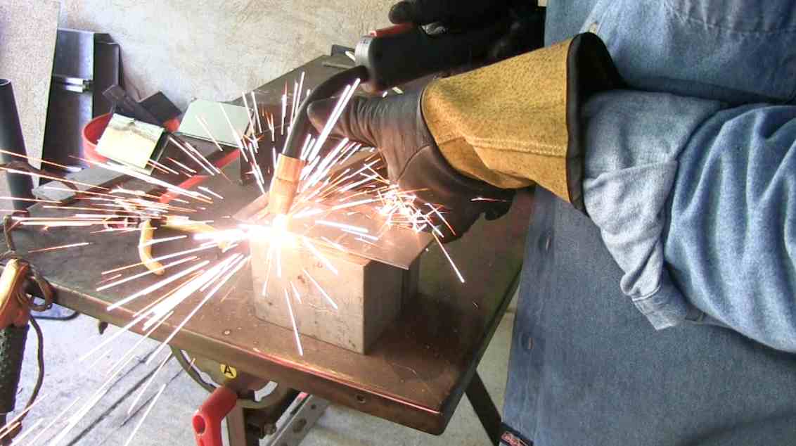

Not just running beads "all willy nilly".  But with intention.
Paying attention, trying to get better with each bead, inspecting each bead and making adjustments to correct little things.
The best way I know to get some good mig welding practice is padding beads.
Why padding beads?
because it requires very little metal, very little prep time.
Most of your time is spent under the hood....getting seat time....exactly what you need.

After you are comfortable running beads...like you can run beads in your sleep...you might want to try your hand at welding some thinner sheet metal.
I welded some 16 ga in this video and because I would recommend welding all thin sheet metal downhill when possible, that is how I positioned it.
Of course, you will need to turn both voltage and wire speed down for mig welding thinner metal.
The thinnest sheet i welded for this video was 18 ga which measured about .048" (1.1mm)
Using .024" wire, it went OK.  Welding thin sheet metal is where you can benefit from an infinitely adjustable voltage knob.  This little hobart 210 mvp has click settings also called tap settings on the voltage.
The wire speed on my hobart 210 is infinitely adjustable so I was able to find a pretty good setting for welding the 18 ga downhill .
And by the way, this aint no commercial for Hobart cause they have forgotten I exist...but its  just an observation that everyone wants to know...This welder runs pretty sweet with .024" wire.
