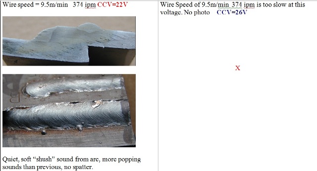

gas metal arc welding test #2 Lap joint fillet and a plain weld bead welded at 22volts closed circuit voltage (under load) and with Wire speed = 9.5m/min 374 ipm

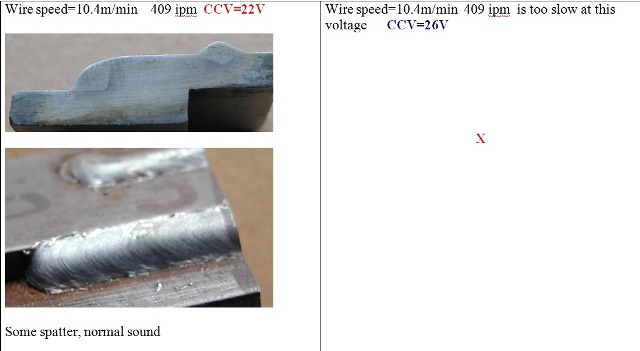

gas metal arc welding test # 3 Lap joint fillet and a plain weld bead welded at 22volts closed circuit voltage (under load) and with Wire speed =10.4m/min 409 ipm

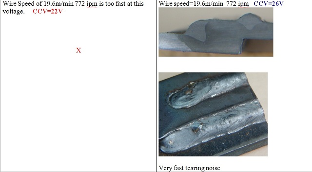

gmaw test weld #8 below shows a lap joint fillet and a plain weld bead welded at 26 volts closed circuit (under load) and Wire Speed = 19.6m/min 772 ipm
mig welding penetration
Wire speeds are listed on the images below in meters per minute as well as inches per minute.
The welds were cross sectioned polished and etched. The weld penetration is plainly shown.
