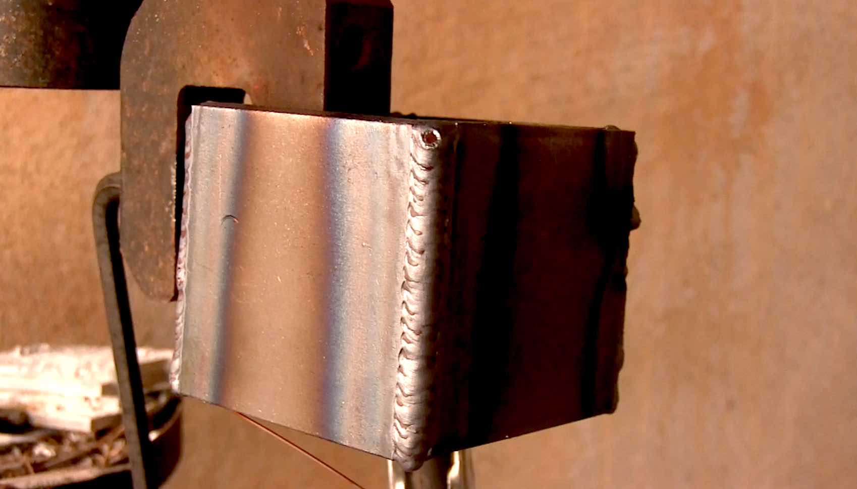

In a prior video where I did a cut polish and etch test on an outside corner uphill mig weld, I saw a straight line indication in the base metal... and so in this video, I dug a bit deeper to see if the straight line indication was indeed a lamination, or something else.
I like to test welds...and when I see something weird, I like to test some more.
...in order to further characterize the straight line indication, I needed to get a better polish so that I could use higher magnification.
So I mounted the piece in some 2 part epoxy that would allow me to use some cloth polishing discs without tearing them up on sharp edges.
Wouldnt you know it?  the epoxy took 16-24 hours to cure.
So had to put everything on hold and let it harden overnight
Walter surface technologies sent me a polishing kit a year or so ago and I thought this would be a good chance to use it to get a mirror finish on the cross sectioned piece so that scratches would not hide any defects.
After getting a mirror finish ...followed by etching, the straight line indication did not have any depth to it.
If this indication were indeed a lamination, it would be more distinct.
Email from a retired Metallurgist
 Hi Jody,
What you saw in today's video is not lamination.  The weld would have been nowhere as good as it was - even noting  the defects in it you described.  A lamination would have blown apart.  What you saw is rather light centerline segregation left over for the steel casting process.  It is not a desirable condition but is acceptable for many applications, especially in lower carbon steel and where the steel is used flat or with easy bending involved.  Centerline seg becomes a problem in higher carbon steel (the carbon and other alloying elements segregate toward the center line causing welding problems such as the formation of martensite in the heat affected zone.)  I do not mean this to be a criticism but am writing you just for educational purposes.
